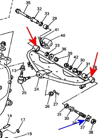

Hi Andy, are you sure that it is the upper ball joint?
In most cases, the bearing left and right at the upper wishbone making noises. Check bearings and regrease.
If you do not get the lock washer (blue arrow), ask me.
Have a look at the english Forum (gtsclub.org) under the threat: Squeak Squeak
It's the same problem.
